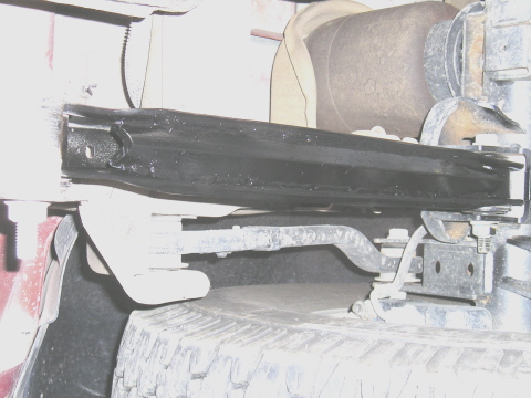

I beefed my stock ones up for $12.00 and it took less than an hour . Saw this comming a while ago. Also the 3/8 inch angle makes a very nice "sliding surface".

I would have paid an extra $12 for this -- should have come from the factory like this. If is cost you $12, it would've cost GM 12 cents.
