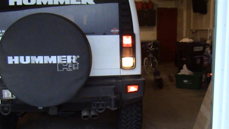

Can anyone tell me please if it is possable to buy the rear bumper brakelights that fit in the corner section of the rear bumper and if so how much are they and will they fit in a 04 h2 please

Yes, I put them in my 03. You can buy the light kit, brackets and wiring harnes, if I remember right for around $250. I got a good deal on mine so don't know retail for sure. They will try to sell you the new bumper end caps that already have the holes cut out but I just dremmeled the holes out. Just make a template of the back of the light and cut. Saves you about $150. On a scale of 1-10 this job is about a 2 in dificulty.

Another

Here's the end cap they will try to sell you, but with the hole cut. Just cut your own hole.

wow, nice job

I am looking to do the same, do you happen to know the part number? my dealer could not find it, they say need to buy the complete bumper ends.

looks great thats what i was hopeing for does anyone have a price or a dealer and a part number please or even a second hand pair i can buy

The Hummer dealer here just had these sitting around in a box with brackets and wiring harness. I installed them a ways back so I don't remember what he told me retail was. I know my dealer called me and wanted me to get the part # of the harness because others came in and wanted to do this mod and they couldn't find part #'s either. I'll crawl uinder my truck and pull the harnes out and see if I can find the # for ya. I think the light kits were $67 a piece retail. Like I said earlier don't buy the 2 end caps it's a waste of money and kind of a bitch to get off. I'll get back to ya.
