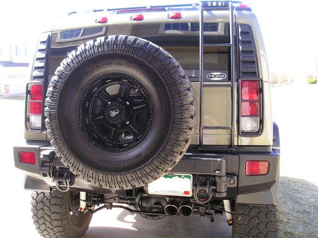

well after the millionth person called me out on not having the matching wheel on the back, I finally put the 5th 24" on.
cut some off.
added a stud.
used four 3/4" nuts for a spacers
I like to use all spline-type lugs so they're easier to start down in the seat
ta. da.

Also, did you add the extra stud for pure support? Were 3 not enough? Also, why the 3/4" nut in the back for the spacer, and can the cut be made with a Dremel tool? Thanks....Jamie
the stud is for support, I'm not sure it needs it, but it really wasn't all that hard, so why not? I used a 9/16" bit to open up the little hole for the stud. Then i used a dremel to open it up a little more, then hammered the stud in from the back.
If I hadn't used the spacer, because it has a different backsacing, it would have sat crooked. I guess I used a nut for a spacer because it's better than a stack of washers.
You can eventually cut anything with a dremal, but I used a reciprocating saw to cut off the support. [that mild steel frame cut like butter] As for how much to cut off; put your wheel up there and mark the most you can leave and still put on the center cap. You don't want to try to line up those studs in mid-air, least of all in the rain or mud or hanging off a 1000' cliff or whatever.
My license plate is just zip-tied to the arm for now, still using the factory light, but you'd never know it, cause you'd be blingded.
How are you still using the factory light?

Default Re: stop calling me out!
zip-ties, baby
zip-ties, baby
Have you seen the mod that I did a while back for relocating your license plate back there. I cut off that entire hub. It's not needed. You can get a new license plate light at Checker or Auto Zone too. Just splice it into the existing wire and mount the new light under the tire carier. Mount the plate to the rear bumper. And your done.
yeah it's quick and dirty for now, I did this while I took a break from installing the Efans. I want to make something like what you have there - looks nice.
What kind of wheels are those Tim?
Have any more detailed pics of the plate light? Thanks for the pic....Jamie
