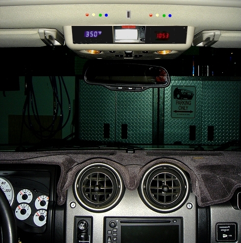

Trade you projects tower. Here's my latest. Tire pressure/temp in the middle, EGT (exhaust gas temperature) on the right, CHT (cylinder head temperature) on the left, & those two gauges are behind smoked glass. The lights above are air/fuel ratio indicators for each engine bank with a rocker switch to turn them off if they bug you. This is acutally photochop image, not the real install. I'm 80% through the modification & it's MAJOR work but will look better than the picture. Taking some real inginuity to make it all come together.

Wow! That looks awesome! I can't wait for the real photos. I like your Hummer Parking Only sign.

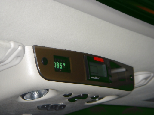

Well tower here's how far I've gotten so far. My air/fuel ratio lights will go above the console but they're on order & haven't got here yet. The gauge on the left is cyl head temp, center is tire pressure/temp monitor & on right is exhaust gas temp. That doesn't show up well in this picture because they sent me LCD black rather than color so I'll be replacing it and it will show up like the cyl head temp. What do you think so far?? Oh, this is bronze glass. When I replace the gauge it will be black glass.

VERY sexy! I'm trying to figure out switch placement. Is that glass custom fabricated?
I'm not crazy about how little room there is in that overhead console for switches. The waterproof switchplate that came with my diagnostic fuse/relay bloc is pretty tall. I will need to either install it below the IP to the left of the steering column, tilted slightly upward, on the overhead tilted downward or have half above and half below the lateral part of the cowl over the gauges. I’m thinking of building a short housing to sit atop that gauge cowl.

tower....that's actually 1/8" smoked plastic. I hand cut it. Just veery time consuming. The console is slightly curved & you can heat the plastic with a hair dryer & contour to fit. When I replace the egt gauge I'll use black smoke. This is bronze. Yes, the console is small & mine is as full as you can get it. No room left. When I'm done I think is will look pretty cool & functional.

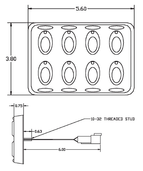

I think I lost the chat room link. The panel is about 5" tall, 7" wide and 3/4" deep. I'll post a photo in a second.

LVJ,
Here are the dimensions. Details at this URL:
http://www.tst-corp.com/pdfs/ttcs10.pdf
