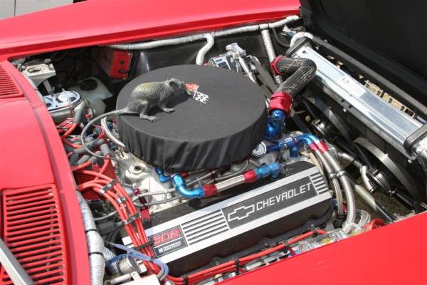

Fulie....Nah.. Don't want no sting-en Fulie... It's a ZZ502 BB with A Barry Grant Toilet Flusher...
