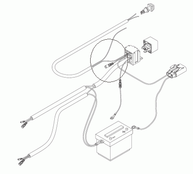

Here is a pic..... The circled wire goes to the brights...
Audio,
Thanks man I will try that, I am guessing that I tie the circled wire in at the fuse panel to the fuse that powers the high beams?
Thanks,
Eric

Originally Posted by HumminNBoatin'
Audio,
Thanks,
Eric
The directions for lightforce say to tap into the actual highbeam wire. I don't know which would be easier. Good luck... Let me know how it goes...
