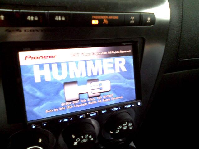

i got a pioneer avic z2 with xm nav traffic backup cam bluetoothand something else. i installed it myself. what stuff do you want to know?

maybe ill snap a pic later. installation was a bitch

heres a pic
(with insurance)

Originally Posted by TonyH3
why ???
ok you have to take off the left A-pillar molding to get at your reverse wire, then you have to tap into a wire behind your lower right kick plate for the speed sense wire, i had to run my mic wired thru the head liner to replace the mic that is for the onstarm there is about 50 million cables i had to splice and attatch. i did not use the GMOS connection as i ditched the onstar crap, so i used a 20 dollar harness that replaces the door chime. over all it took me about 2 weeks to get it all how i wanted. and i did a real ****ty job too but it works good tho
(with insurance)
