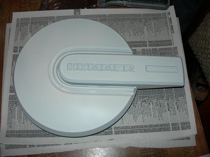

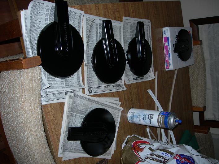

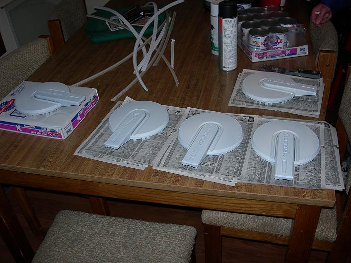

Ok, so as a HOAB member I wasn't happy about all of the chrome on my new Alpha. Since I can't afford to get all new rims quite yet, I took some inspiration from a local cop cruiser. I took all the lug nut covers off the hum I just totaled. I went down to sherwin williams and asked for the best toughest industrial primer for this plastic. I ended up getting X-1-M 400. I also got Sherwin Williams Industrial and Marine Coating Rust Preventive Paint in Semi Gloss. Here's pics of the prime coat. When's they're finshed, they will be exact opposite of a cop rim, chrome spokes with a black cover. What do you think?

Ok here's the first coat. I'm going to recoat in 70 minutes to make sure it's still flexible to give when the next coat dries. I think they're turning out really well.

I scrubbed the wheels down with a wet cloth to get any large bonded molecules off. Then a thorough sanding with 800 grit wet/dry sandpaper. I then wet clothed it again, waited for it to dry then dusted it with an old paint brush. I then primed it, and gave it 4 days drying time to harden and bond. Then a top coat wait 70 minutes, dust, then recoat. I getting ready to take a pic after the 2nd coat now.

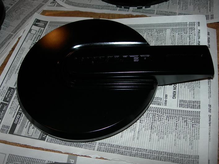

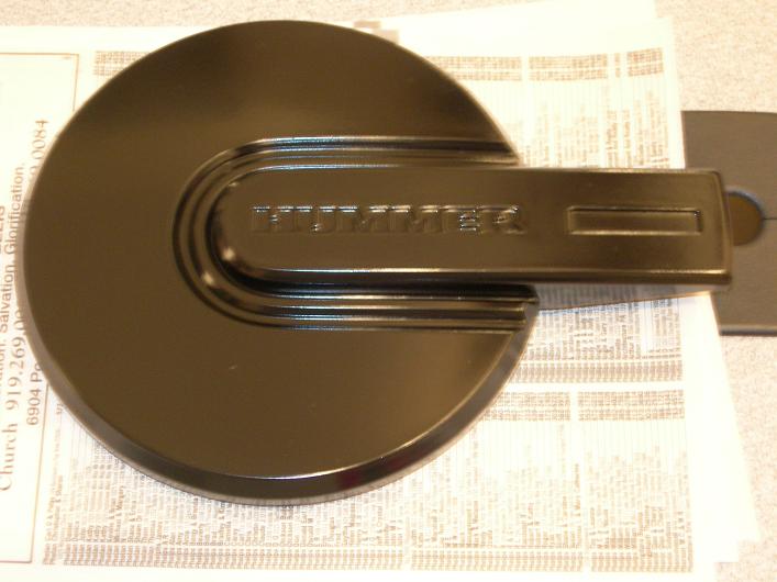

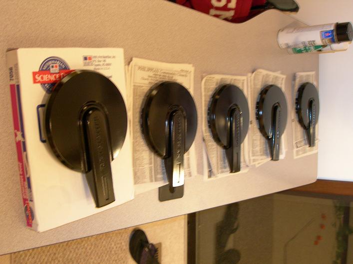

Ok here's the finished product not on the truck. How do you guys think it looks? I will take a picture of the truck tomorrow in the daylight. I have tomorrow off!!!! Yeeeeeeaaaahhhhhh!!!!! God! Only 61 hours this week. That entirely too much for a guy even the French would call galently lazy!
Oh yeah the last pic is the products that I used.

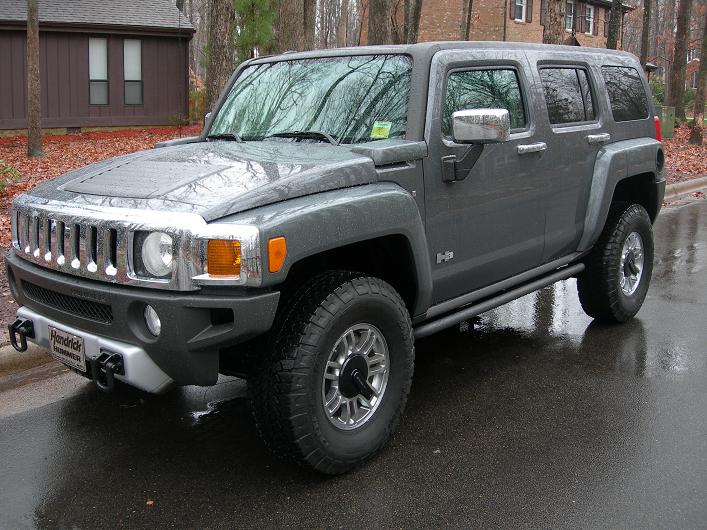

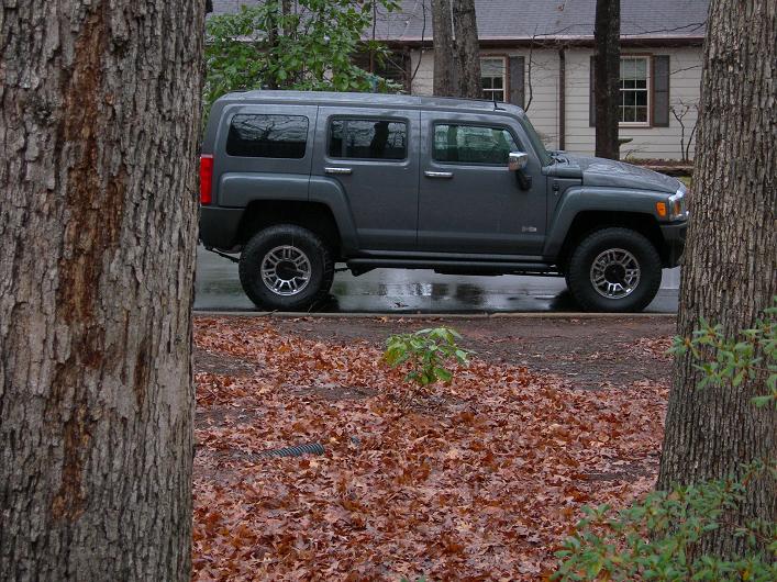

Ok it's raining balls out here, but I took some pics anyway. I think it tones down the chrome an incredible amount. I also have a set of airboxs from my last one that I'm going to paint the same black with an air sprayer.

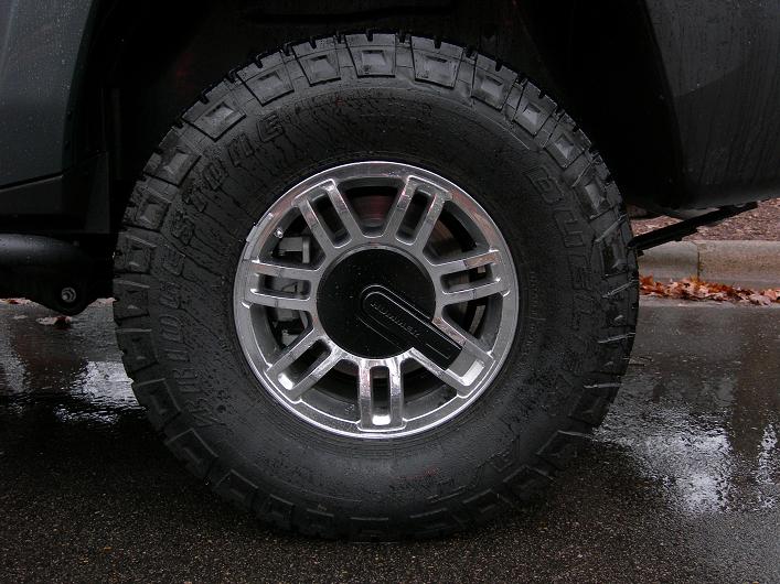

Ok, I've started my project. I purchased the primer and paint you recommended from Sherwin Williams and have finished the caps, now for the hard part, the wheels.
Do you think the wheels can be done with lots of tape and paper with them still attached or do you thinkg they have to come off?

Get a deck of playing cards and just stick them between the tire and the rim. Fast, cheap and simple way and it'll give you a nice clean line around the rim edge. No need to remove the tire.I would still remove the rims from the truck to prevent overspray getting on your paint. It's also easier to get a nice even coat and to get into all the little crevices. Good luck.
