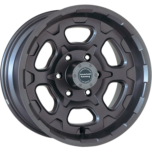

these are the wheels I want but dont know if they will clear size is 16x8 6x5.5 + 20 5.25 bs will these work with the rancho kit

Those are the same wheels I was looking at!!!

these are the wheels I want but dont know if they will clear size is 16x8 6x5.5 + 20 5.25 bs will these work with the rancho kit </div></BLOCKQUOTE>
Those will not work with the kit. Too much backspacing.

these are the wheels I want but dont know if they will clear size is 16x8 6x5.5 + 20 5.25 bs will these work with the rancho kit </div></BLOCKQUOTE>\
The next one down in the catalog will, but will have 4.5" bs.
3985-6883 16x8 0 4 1/2 6-5 1/2
Old 11-20-2005, 09:22 PM
thanks H3guy just looked at catalog and the one you recomend is perfect . was also wondering if would be better to go with a 17 but not sure if 9 in width would be too wide what diameter and width would be best rancho says they used a 20 inch rim . I prefer a bit smaller wheel for lots of tread width when airing down .

Any of the wheels with 4.5" backspacing should work. The rim width will not effect the knuckle to tire clearance.
Old 11-20-2005, 11:25 PM
<BLOCKQUOTE class="ip-ubbcode-quote"><div class="ip-ubbcode-quote-title">quote:</div><div class="ip-ubbcode-quote-content">Originally posted by H3 Guy:
Any of the wheels with 4.5" backspacing should work. The rim width will not effect the knuckle to tire clearance. </div></BLOCKQUOTE>
TRUE! But by going with a wider rim, it will make it stick out passed the wheel wells more. When I talked with the guys at Ranco, i told them I want the tires inside the WW's as far as possible and wanted to go with a 16 or 17" rim. THey said go with the 8 X 16 with 4.5" of backspace and go with a 35" tire. So, that's the plan in about 3 weeks if all goes well.
