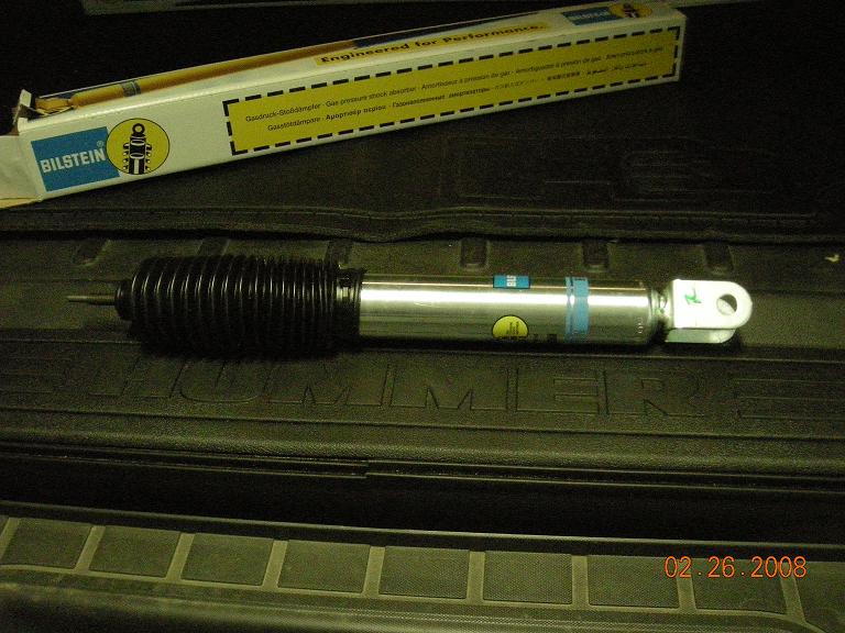

I bought Two From www.trailduty.com and after I have read Countless Post on this Subject I am now wondering if they sent me the rears instead of the fronts, or is there a Difference? The First Picture is a front install on another site. The Second is a Picture of the Shocks they sent me. The Boots are reversed. and there is a "R" written on bottom mount. Any help would be apprecited before I start the install. Thanks

they are fronts!
installed mine not too long ago and are exactly the same as yours!

I put the same front shocks on mine last week. Part number on the box was F4-BE5-C153-HO. The boot on yours is in the correct place.

I double checked the part # and went ahead and had them installed today.
Everything is great!!! Wow what a Diffrence.
thanks

Just a slight difference. The rears use a barpin (top) and eye (bottom) mounts. It would be quite a trick to make those fit.
Looks like Cognito changed the shock they were using to make these. I can check the exact part # when I get home, but IIRC, the ones I got (in that pic BTW) were originally made for a Ford.
