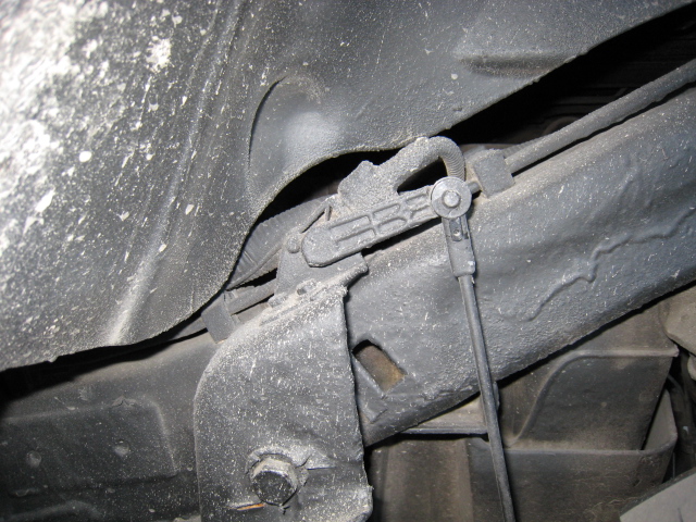

Old 04-24-2008, 04:13 PM
Hammer Hammer is offline
Location: Finland
Posts: 126
Hammer is off the scale
Post Re: H2 leaning to Drivers Side, I thinking Air Bag? Help!!
I noticed today that my driver side air bag is empty no air at all. Driver side sensor was replaced about a year ago by local hummer DEALER !... Both air bags fill up and car levels out side to side when I push the height control button. No leaking . But for some reason driver side sensor is not working correctly it loses air out from the drivers side air bag when driving over ~ 50km/h. And it becomes very unstable to drive. Passenger side air bag works fine but its got a lot of stress because drivers side not working...I have had nothing but problems with the damn air suspension My truck is -03 with rancho 4" lift No message on DIC
Is it normal that drivers side sensor is like it is in this pic? or does it even matter after the system calibrated

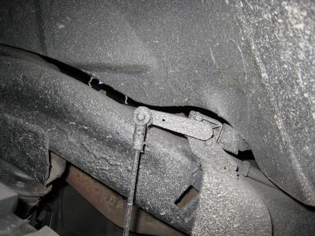

Old 04-24-2008, 04:32 PM
Location: Finland
Posts: 126
this is passenger side sensor

Old 04-25-2008, 12:13 AM
HUMTECH's Avatar
HUMTECH HUMTECH is offline
Location: Canada
Posts: 1,251
HUMTECH is an unknown quantity at this point
Default Re: H2 leaning to Drivers Side, I thinking Air Bag? Help!!
You need to get the faulty sensor replaced and then a trim height learn procedure is required for the system to operate properly. Requires the tech2 scan tool for the learn procedure, no way around it unfortunatly.
