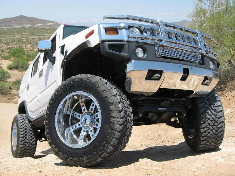

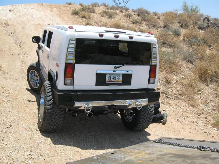

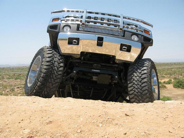

Take a look at the damage pics. Legends Cadillac (A local Arizona Hummer Dealership) wants $1522 to fix drivers side broken "center link". Am i getting ripped off? Let me know what you guys think! Is there any aftermarket parts to solve this problem?

Sounds pretty high! You can buy the centerlink with 2 new inner tierods for around 310$ (estimated, I bought for 280 a few years ago) gm parts direct , was the site I believe. Sounds like way too much for labor.

That's a broken tie rod. $80 at the stealership. Buy some much sturdier ones from FABTECH.

typically when you break the inner tie rod the dealership tries to make you buy the entire centerlink assembly even though all you need to replace is the tie rod. As suggested, buy the tie rod only, better ones if you like. Get someone other than the dealership to do the work for much less.

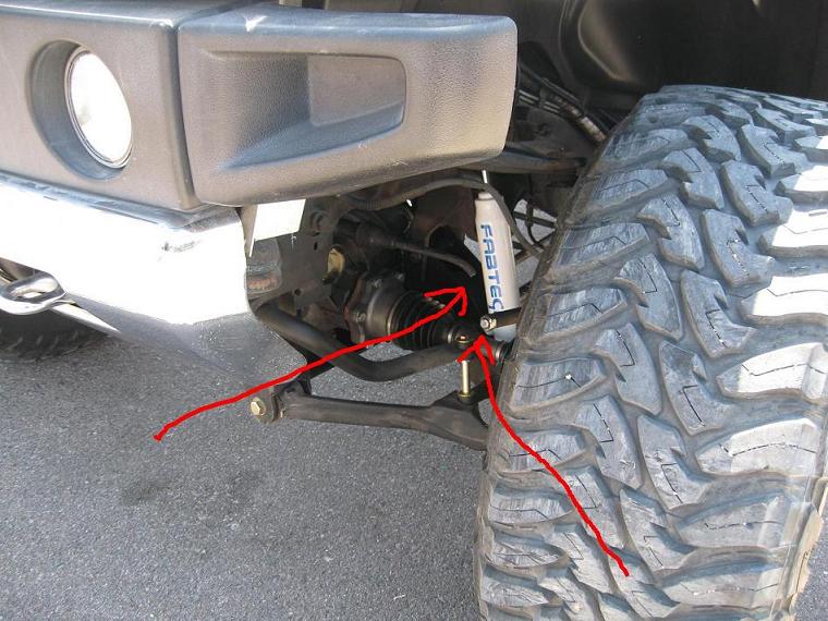

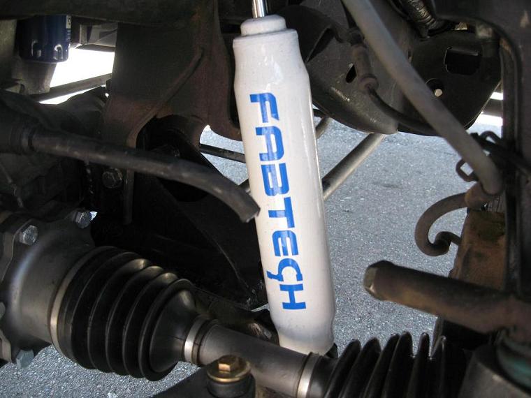

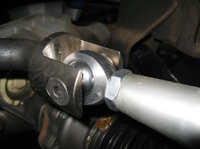

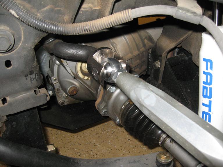

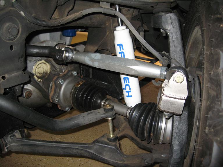

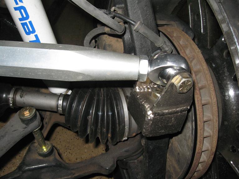

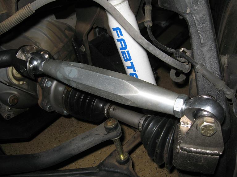

Thanks for all the help guys! I was going to order the Fabtech tie-rods, then the dealer suggested these. When I first saw these, I was impressed! When I asked what brand these were they said they were custom made. Anybody recognize them?

I've never seen anything like those, but they look beefy and sturdy! I like it a lot.

I have got to get a set of those!!!!!!!! Post up some contact info for those and also a price. Pleaseeeeeeeeeee

Whoa searched on line and found these!!!!
http://bulletproofsteering.com/gmifstierod.html
Old 07-19-2008, 08:44 PM
splne1's Avatar
splne1 splne1 is offline
Join Date: Jun 2008
Location: Virginia Beach, VA
Posts: 784
Default Re: Arizona carnage
I am considering just buying all the parts and making my own set? Looks simple enough. Some spherical ends a couple of bolts and what looks like a sway bar end link???

HIEM JOINTS FOR OFF ROAD ? are not the way to go, unless you plan on just cruseing VanBuren sporting your bling get the Fabtech tierods. noticed you are a used car dealer by your plate. so you should know better than to trust the word of a Hummer dealer ,he will high gross you to death .
