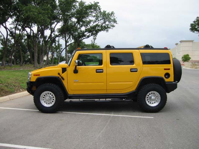

whats thats the tallest tire I can fit on a stock h2

I was thinking the samething, then I realized he posted it at 8:30pm. It's party time in NOVA. (He'll/She'll get it...)
37" is generally accepted on a stock H2.
Old 07-23-2008, 06:18 AM
Default Re: tire question
37x12.50x17 will be fine as long as you use stock rims or rims with the EXACT offset as stock rims.

[quote=DRTYFN]37x12.50x17 will be fine as long as you use stock rims or rims with the EXACT offset as stock rims.
Attachment 49060
Much problem with rubbing ?

I have 37x12.5 on a 20 inch rockstar. A little rub on a full turn, you can crank the t bars a little for and added inch or two.

Depends on where you have them done as well. The guys who did the initial install on mine did great, no rub at all. Then the dealer screwed it up.
