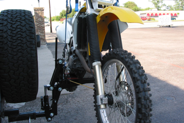

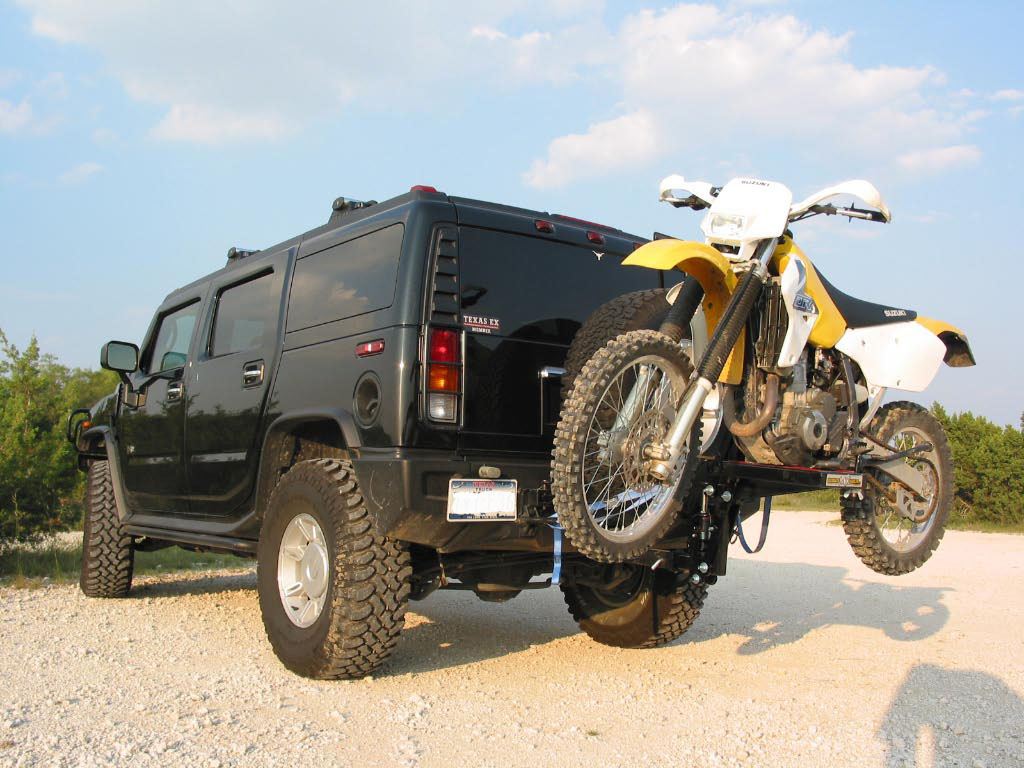

I run this one. It was made by ultimatemxhauler.com
He made an extension piece to accomodate the spare tire and drop the carrier down because the H2 hitch is so much taller (especially with my 37s).
We took custom measurements to keep the bike as close to the hitch as possible.
Let me look around for a detailed pic of the extension/drop adapter.

This shows better detail on the extension. My bike weighs about 285lbs with all the stuff on it now. I haven't had any issues with it.
