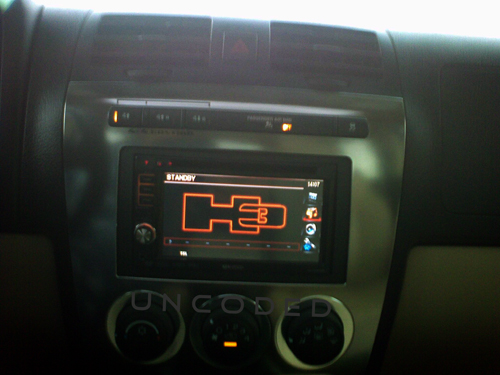

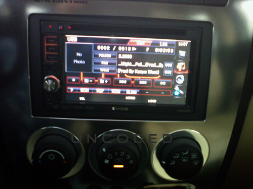

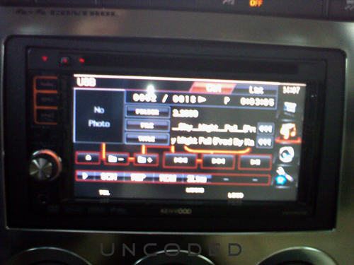

What Do you think guys?
**My Kenwood DDX5032 Features:
1- Bluetooth phone connection
2- On board TV
3- USB/I POD player
4- on board Garmin Navigation system
5- DVD-Divx Player
6- Rear View Camera

Looks good. I like the H3 logo wallpaper. Does it work with Onstar and the factory Monsoon sound system?
it works perfectly with on star and monsoown system and also you get more control over the subwoofer all you need is the harness (GMOS-4 from Metra)

how did you get the H3 logo to appear.....ive tried to load pics into mine with no luck at all and i have the same head unit.
If you load the background as the manual says then it will appear when you press Standby.
