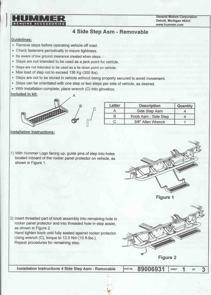

Ok, this is a dumb question...but I just bought a used set of the quick release steps for my H2. Really easy to install. My question is: Which way is the quick release knob/screw screwed into the step? In other words do you screw it in the opposite way the steps are installed, or do you screw it in the same way the steps are installed?
I went with the opposite direction, because if the screw backs out to the safety key, it should stay attached, but I want to make sure.

I also have the "U" steps, new, and still have the original installation instruction sheet if you would like a scan of it.

Default U-steps Installation Instructions
Please find the scan attached to this post.
KEYWORDS: U-step removable 89006931 side step steps OEM GM factory installation instructions manual guide
Full-size image on my server, too large for Elcova upload
