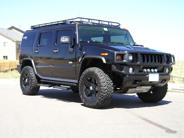

Old 09-09-2009, 08:54 PM
Default Re: tire size clarification please
toyo MT 35 12.50 18 on 18 X 9 RS's. 37 12.50's would have been tight at stock height. 37's on the stock wheels work well (12.50 wide) at stock height. As soon as you go away from teh stock offset/ backspace, you'll have to do test fits.
The 18 X 9 has 5" backspace and worked well offroad.
nice looking truck!
