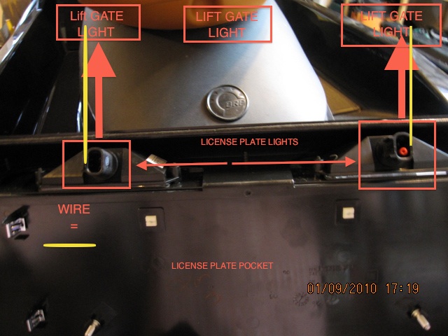

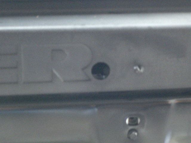

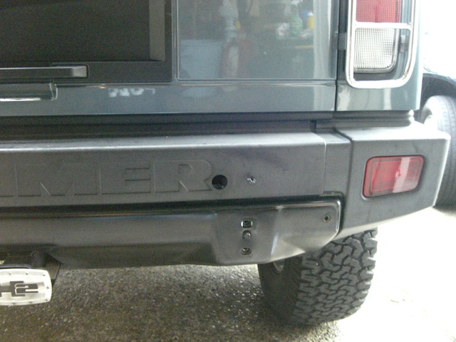

Here's some pics of what I'm left with. This was a factory rear mount, so there is no light where the license plate space is...
I figure for the 3rd bolt hole in the bumper, and the big hole where the plate light wiring came through I could just get a black rubber plug to plug it.
Any suggestions on a light for the OEM plate mount and or bumper hole fixes?

Old 11-25-2009, 03:24 AM
pdxrealtor's Avatar
pdxrealtor pdxrealtor is offline
Join Date: Feb 2008
Location: Portland, OR
Posts: 948
pdxrealtor is on a distinguished road
Default Re: SUV- Rear Spare Is Off... best way to finish job
Ok.. so...
the dealer wants just over 400.00 for the OEM chrome piece that goes along the top of the OEM plate location.
Then it will have to be wired up, drilled, etc..
Anyone have any other ways they could share?

Hi mount your plate in the trailer hitch if you don't tow and plug into the trailer plug in the bumper for the light or on the bumper with a lic. plate light and cover the holes from the removed tire rack. lf you don't you will have to run the wire back up inside the rear hatch. Maybe the plate light wire is already in the hatch but you will have to remove the hatch inside panel to see if its there.

Orr.....
Take the plate light assembly from your old spare tire mount an retrofit it to fit inside of your rear door pocket. (Its not just the chrome piece you are buying for $400....Its the whole plastic pocket.)
You should be able to pull out your existing door pocket and cut holes in it for the lights to shine through. I would just use epoxy to fit it to your door pocket from the inside.
On the rear bumper you are going to need factory tow hooks to finish off the job. And you are pretty much stuck with the holes in the rear bumper that are left over.... However I may be selling my whole rear bumper soon..... I also might have a line on some tow hooks if you are interested.

I think I'll just end up plugging the hole in the bumper with a rubber plug... that won't bother me too much.
The tow hooks I might take you up on... I've got a couple people interested in my OEM rear tire carrier, which has the hook attachments so the buyer would give me theirs, but if that falls through and I'm ready I'll need them. I hate to buy them though, when I can get them in the OEM tire carrier deal.

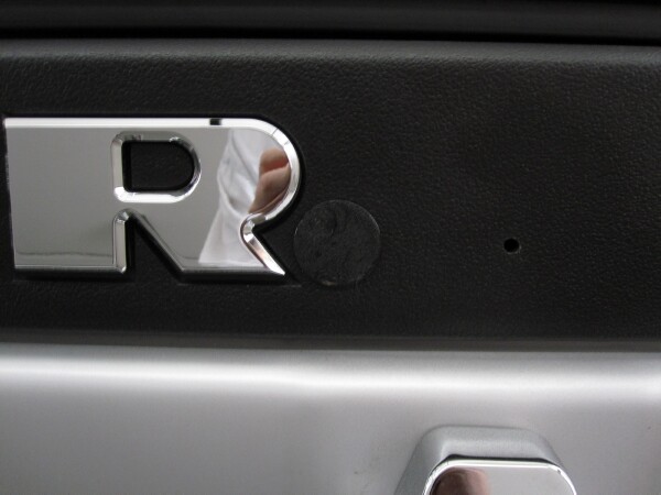

I did the same thing when I got my H2... Wheat I did was order the Pocket, like mentioned above, from gmpartsdirect.com. I gave around $250 for it. Then I had to order a new wiring harness because the one that is in the lift gate doesn't attach to where the lamps are above the license plate. Then, I had to run power from the marker lights down to the license lamps because the vehicle is not wired that way from the factory.
Then I went on eBay and bought some factory hooks from a 2003 and bolted up in place of the bulky mounts for the rear spare holder.
Next, I went to Lowe's and bought a metal hole plug, primed it, and painted it flat black. When you Armour All the bumper the flat black matches it perfectly.
Before:
After:
Before:
After:

I bought the metal plug too, from Home Depot. It takes a while to find it in the store but it's there, you gotta keep looking. I painted it with Harley Davidson "wrinkle" flat finish spray paint. It matches the bumper perfectly. I made the mistake of buffing it out though, so it isnt as black as it was at first and it took some of the wrinkle finish off too...

The rear pocket did end up as a good fit, so I ordered it from GM parts direct. It just got here today..... the wire harness was on back order because they did not have anyone to make it for them. I think I have it worked out but need verification..
I've attached this pick to make it easy for you guys to understand what I want to do.
Will this work without blowing fuses or hurting the electrical system?
Name:  LICENSE POCKET DIAGRAM.jpg
Basically tapping into another light source for the license plate light power.
