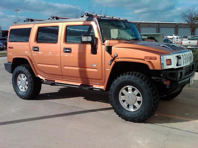

I JUST PUT ON MY 37X12.50'S AND I DO GET A SLIGHT RUB AT FULL LOCK, BUT NOT ENOUGHT TO BUG ME TOO MUCH. I LOVE THE LOOK THOUGH.

like the look of those goodyears i guess its to early to tell how they stack up to the bfg ko,s nice rig as well like the color thanks for your input
