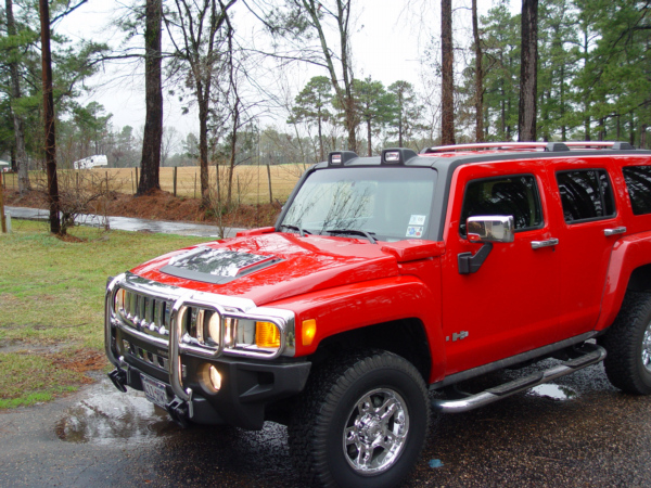

went out and got this today

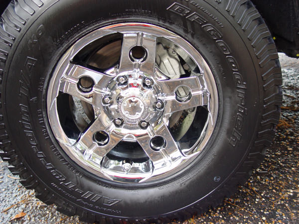

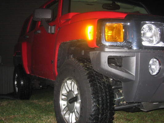

And Old

Looks much better, good job.

How did you lift the front end? Torsion bars, Lift Kit????

Humdoug there s no lift on it its stock unles they play with it a the dealer before i got this truck . I have not touch a thing i only got 1 inch biger today the guy at the shop took his tape and only went up 1 inch , so maybe if i do the torsion bars trick i can level it off . im waiting for RCountry to get the lift out to try it .

Wow. What a difference! Looks great!

What size tire?

LT285/75R16 D all terrain KOs 2 . thats it . i went in looking for toyos instead i end up getting this.

Good tires, a lot better than those Wranglers.

The Goodrich ATs with the KO thread are not only good looking tires but they last. The sidewall is stiff however so you'll feel the bounce. You may want to lower the pressure a tad to adjust. You should have taken the blackwalls however as those white letters are a bitch to clean and you have to clean them if you want to look good. Small tip, those soaped up SOS dishscrubbing pads will work marvels...

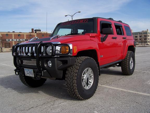

Get new wheels man.... Hummer's wheels are ugly You almost got the same tires as me :e

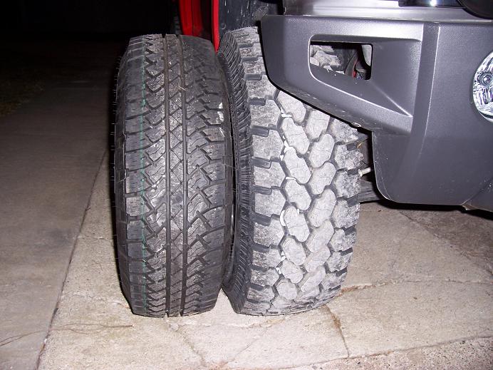

I put on 315/75R/16 (35's) ProComp Xtremes with the same width as the ones you want. Very slight rub on sway bar on full right turn. It hasnt been a problem as long as I dont lock steering full right. When I got my new tires mounted the guy didnt have to recal the air sensors. He just remounted and aired them up. He said they were in sleep mode....O.K. I havent aired them down to see if there working but he said there should be no problem. I did turn my torsion bars 2-1/2 turns to raise the front end. Plenty of room, but I havent really tested for rubbing on severe wheelin yet. Heres a pic of my old 33 with the new 35's

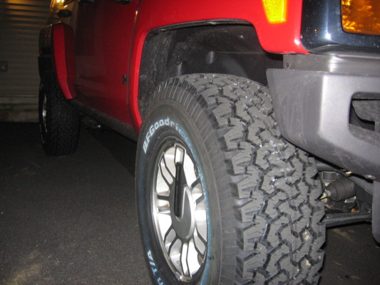

one more
