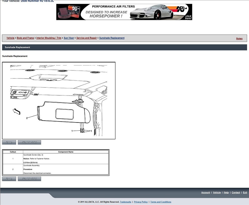

Oh then their is 3 screws that hold the sunvisor up, are the 3 screws their? if they are there the little nut sert must have came out of the steel under the headliner. You need to remove the driver side weather strip and the front window inside corner trim piece and handle and lower the headliner abit so you can see if the nut serts came out. Maybe post a picture of the headliner sunvisor so i can see what has happened. Hope this helps.

Hi maybe this help
