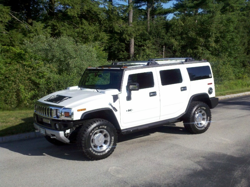

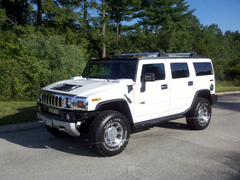

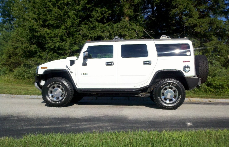

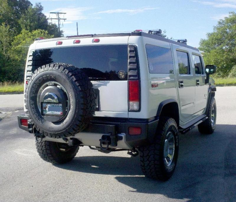

Just added these and I'm pretty happy with the fit and finish.

Very nice!

Do they come powder coated or painted?

They come through powder coated a semi-gloss black. They fit right up to factory location and are "Hitch steel" very rugged. I added the step treads to them.

It appears in the photo that there is a different texture where you would use them as a step to get into the vehicle, is this correct? If so when did you buy your sliders? I got mine earlier this spring and they are not like that. Not a huge deal but definitely have slipped once or twice on them when they are wet.

I added aluminum treads for just that reason. They are 1/8" thick and I coated them with bed liner paint. I used 3m tape on the back and they haven't moved or had a problem. I got the treads from my metal supplier.
Try this CO. www.mcnichols.com
