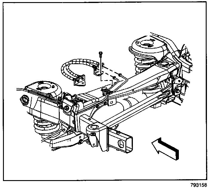

look straight up above the differential on the rear axle.
Name:  brake hose - rear.JPG

Old 08-10-2012, 10:05 PM
pdxrealtor's Avatar
pdxrealtor pdxrealtor is offline
Join Date: Feb 2008
Location: Portland, OR
Posts: 948
pdxrealtor is on a distinguished road
Default Re: Brake System Flush
Sweet....
