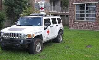

Water on the windshield is just a "Hummerism." X2 on changing your fluids after deep water runs. H1s do it too but have factory extended vent tubes! In the case of the H1 they are designed to sink and not float and some of this carries over to the H2 and 3 and may be partially responsible for the way they throw water. Is this the H3 you saw? Hummers are still the best vehicle out there for many uses.
American Red Cross of Southeast Louisiana Hummer H3 photo
