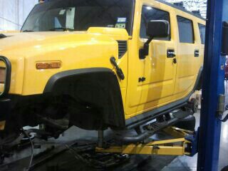

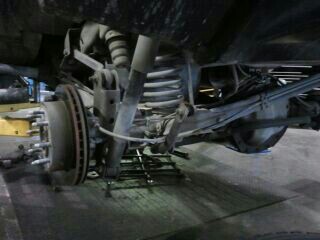

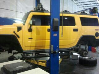

Funny you asked...had some minor setbacks which delayed the finished product. Apparently today my stock gears were frozen and it took over 4 hours for them to free them up. But I popped in on the shop unexpectedly, and things were moving forward. Hopefully tomorrow will be the day!! I attached some progress pics.
Why only do the leveling kit?
