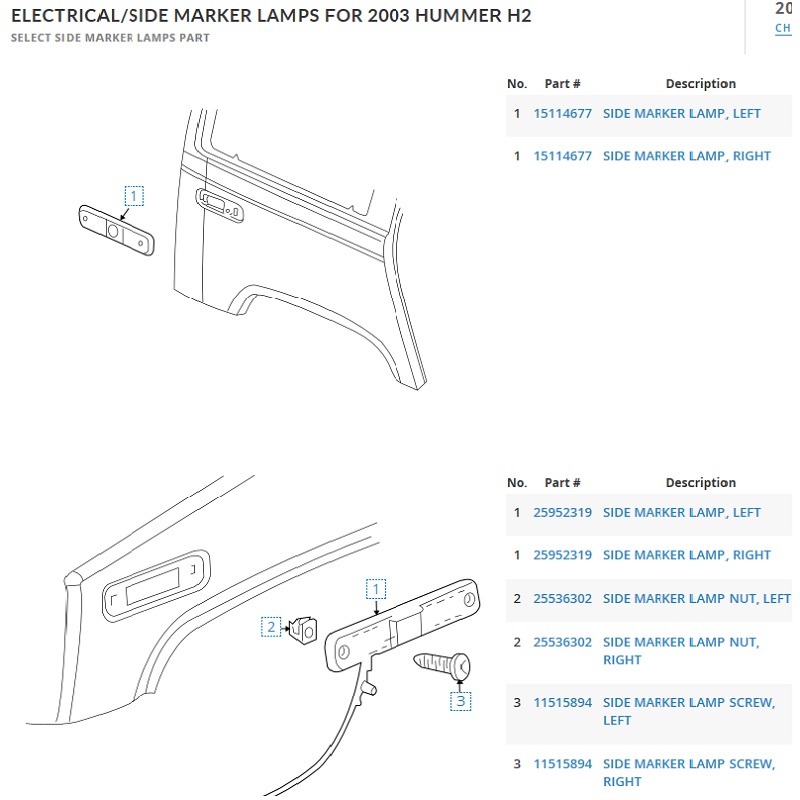

Name:  Side Marker Lamps.jpg
http://www.gmpartsdirect.co/auto-par...ker-lamps-scat

There aren't light bulbs in the side markers. There are 2 surface mount LED's soldered to the board in each side marker. The unit is also sealed so unless you cut it apart you would have to buy a complete new marker unit.
