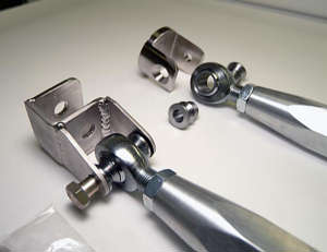

• May 2004•
FST (Fabrication Suspension Technology) GM steering upgrade
Press Release
• Chevy and GMC 4x4 •
Immediate Release
FST (Fabrication Suspension Technology) has developed a steering upgrade for GM models that are equipped with inner socket and tie rod style steering. It's easily installed using factory geometry points. Not only does it offer the proven extreme heavy duty durability of ¾" 4130 chrome-moly heim joints and 7075 aircraft aluminum, it has an industrial look as well.
This upgrade heim joint steering kit is available for the following vehicles:
GM HD 1999 - current
GM H2 Hummer 2002 - current
GM Quad Steer Rear 2003 - current
GM Quad Steer Front 2003 - current
GM ¾ ton 1999 - current
GM 1 ton 1999 - current
GM 1 ton dual 1999 - current
GM Avalanche ¾ ton 2003 - current
GM Avalanche ½ ton 2002 - current
GM ½ ton 1999 - current
½ ton Yukon 1999 - current
¾ ton Yukon 1999 - current
½ ton Yukon XLT 1999 - current
¾ ton Yukon XLT 1999 - current
Contact Information:
4401 W. Jefferson Phoenix, AZ 85043 602-484-7127.
www.fstmotorsports.com

photos
