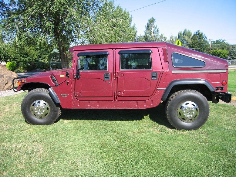

Ok, so a nearby dealership just got a 97.5 slantback in from alaska. I've been thinking about the possibility of trading in the H2 for the H1. With the ramblings in my head, I've decided if I were to do that, I would like to run it on bio-diesel / B100. I've looked at SVO/WVO and stuff, but I don't feel like adding tanks/modifying the engine. Has anybody had experience with running a vehicle on B100?
I'm thinking I could hit up the local asian restaurants and mom/pop restaurants for the oil, and then purchase a mixer kit ($4k) to mix it up. The only concern would be storage (in the garage?) and cold weather operation. I know you can purchase additives for cold weather...but not sure on cost.
Any comments would be appreciated....

People are running it here in Vermont. It cost more...but people tell me they cannot feel a difference between the two. Also the exhaust smells like french fries!
If I bought it I would take the hub caps off (I don't think those are wheels) and then I would remove the sun visor, and mud guards!
