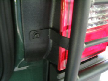

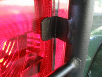

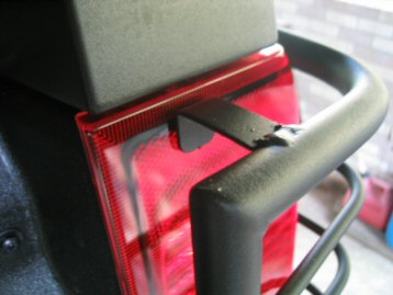

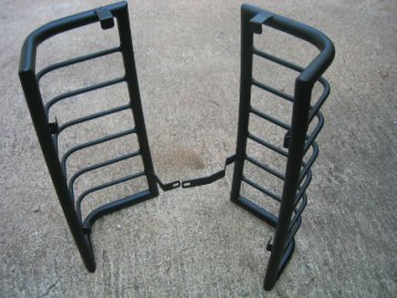

I do not recommend the Manilk tail light guards. They are made all right but they mount with one screw and the other mounting points are all stick on (double sided tape) to the tail light itself. If you bump it very hard you are hitting the tail light, so much for a guard.

On the tail lights you will see two screws on the inside edge when you open the door. The guards ues the bottom screw on the right and left tail lights, then sticks on at three points with the double sided tape that comes with it. PISS POOR design I think.

That's worse than having no guard at all! Now you are going to place all the force of that branch or whatever to these monting points. DAMN IT! I was just about to order these. Thanks for the info guys. On my SUT they actuall se the factory screws inside the tailgate area and than you drill two moore holes just outside the taillight. VERY SECURE.
Can they e modified in any way. How about a couple of pics from the side view where they mount? Maybe we can fab something up.

Pictures of tail light guard

I'll try again.....

one more...

last one, I'm tired...

OK, thanks for the pics.
So, I think that top bracket could be modified to go behind the tail lamp, but the other one, I'm not sure on what to do with. I'd have to get a pair of those to modify.... or just fab up a set. I'll pull the tail lamp this weekend and figure something out. I'll get back to you on this.
Old 08-19-2005, 11:03 PM
Ok, I couldn't wait. I just went out and pulled the bucket out. This will be easy! (famous last words). The challenge will be where the door swings out (dr sd). The brackets will be like the SUT ones. Anyone afraid to drill two tiny holes, push in a gromitt (SP) and screw them in place? The way my SUT ones go in! A little silicone and your done. Should take about 20 min to install. (estimate). I'll try to work on this over the next week or so.

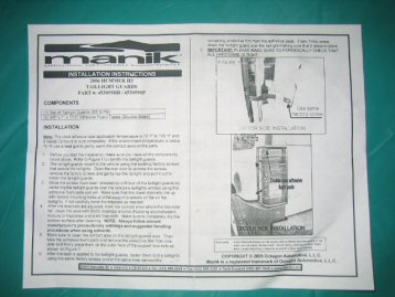

Manik is now producing a new Tail Light Guard for the H3. The mount brackets, which used to mount on the outside of the lens with double sided 3M tape have been replaced with new ones. All the brackets now firmly attach to the vehicle using factory screws.
Manik will gladly replace the first generation Tail Light Guards for anyone who is not pleased with the design. Please contact Manik Customer Service at (800) 457-7645 for a replacement, or if you are interested in seeing the new design we will e-mail or fax you the installation instructions which show the new bracket design.

Please call our Customer Service line at (800) 457-7645 and we will send you the new installation instructions. It explains the new mounting method. The actual Tail Light Guards look like the original design except the brackets are different.
