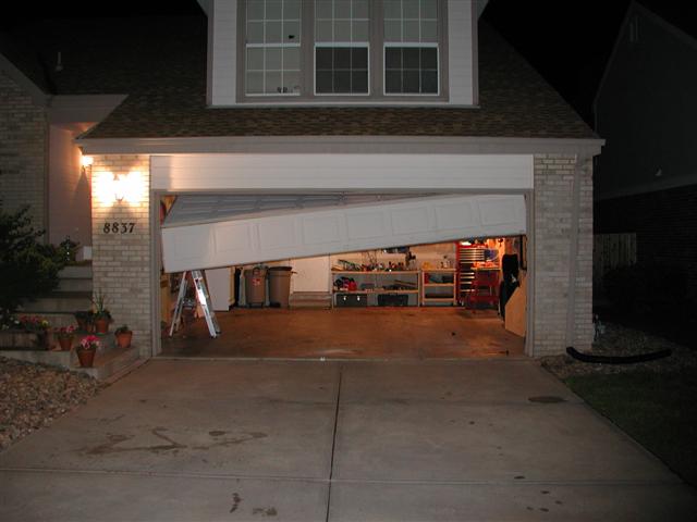

Here's the impact of larger tires for ya:
