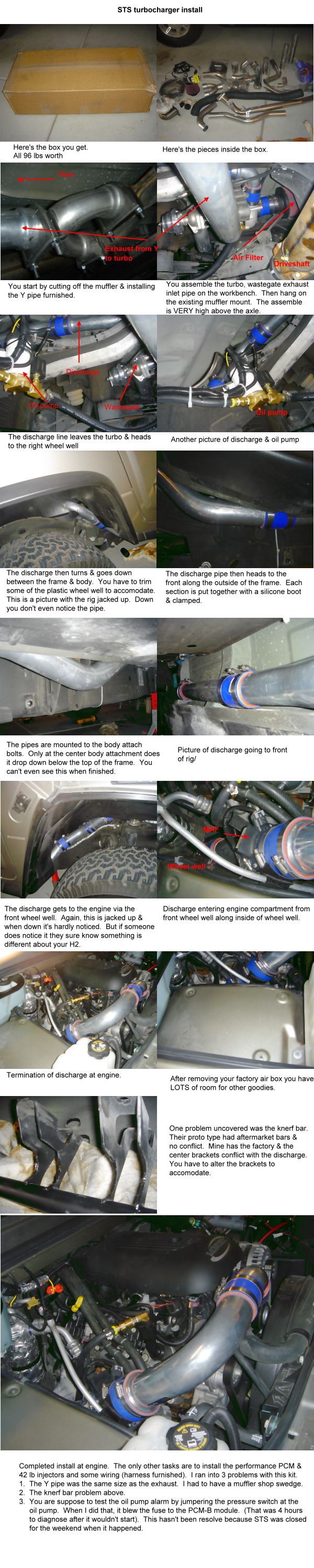

Well, almost. In the interest of the forum I did the install myself to determine practicality. The kit is installed & running. The 42 lb injectors aren't here yet so I can't install the PCM tune & I can't boost it for fear of getting on the lean side. The injectors should be here
Mon/tues & that will complete the project. Even without boosting there's a huge difference. It has that distinctive turbo spool up sound & the response is nearly immediate to end the "lag" debate. The kit is very high quality & anybody with average mechanical ability can install. In 4-6 hours as advertised....no way. Maybe two people in a long day or one person 8 hours if he had done it before but not 4-6 hours. Here's some pictures of the install. I'll have more performance information after installing the tune & injectors. For those interested in turbocharging their H2 I'll probably be entering into a "special" arrangement with STS just for members of the forum. There will be major discounts to forum members. Anyone interested just PM or email me. <span class="ev_code_GREEN">4/25/05 Update on the fuse blowing problem below. Turned out to be a simple short in the alarm connector</span>
Jonahs

Great Jonahs keep Us up to date. I bet You are going to have a harder time keeping Your foot out of it for a few weeks. Install looks sweet. If a person wanted to not let people know what was there. I think Jason has that fender well liner kit that hide piping. With tubing being cold air it would not melt rubber liner.
TAZ

Frankly, if you do look at it it looks pretty cool. I might paint it black but either way it's hardly noticable.
Jonahs

If you like sound this has a really cool throaty sound to it. I'm having Midas add a Flowmaster 70 after the turbocharge that will bring it back close to stock on sound but for those that like a performance sound the turbo is cool. Sounds beastly!!
Jonahs

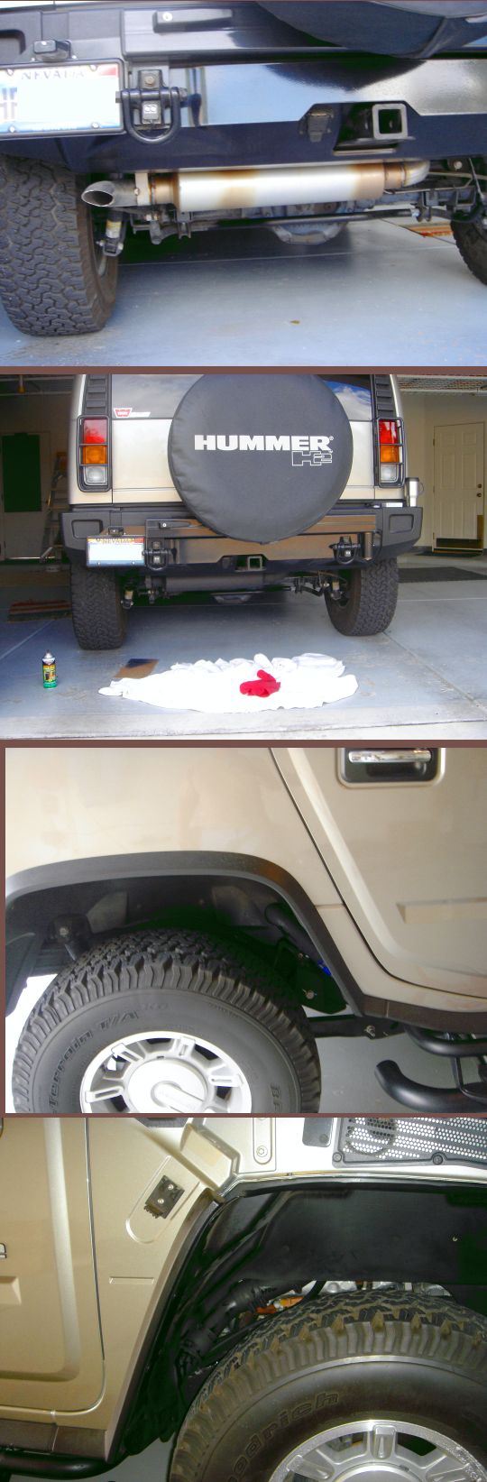

Between me and Midas we engineered installing a Flowmaster 70. Amazingly it ended up looking like a factory install. After painting you don't even notice it. It's actually quieter inside than stock (probably a combination of the turbo & muffler). I also painted the discharge tubing in the wheel wells & again you have to look for it to see it.
Jonahs

Jonahs - how does the FM70 sound outside the truck compared to stock? Just curious...

Jonahs - how does the FM70 sound outside the truck compared to stock? Just curious... </div></BLOCKQUOTE>It's difficult to judge by my rig because the turbo muffles the sound and then the Flowmaster 70. So it's very quiet. A little throaty but as quiet as stock inside. Maybe even quieter. Fine for me, I'm not into sound. I want it to go fast but look/sound stock!
Jonahs
