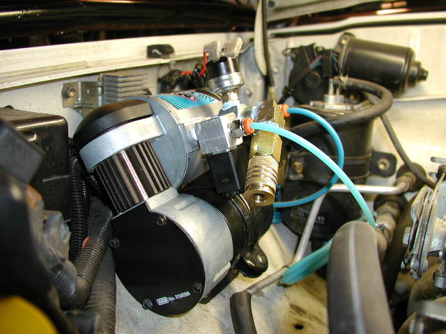

One down side to the A.R.B. is even if you have the air suspension you will need another compresor. I dont think the one the H2 comes stock with has enough pressure to operate the A.R.B.
IMHO since the Hummer comes stock with an Eaton, why not stick with the same for the front?

Hi Guys, I have not been lurking for a while. Let me say hands down go with the ARB Air Locker over the electric. They are tough as nails and ARB USA backs them up with killer service even if one is out of warranty.

I had both front and rear air lockers in my jeep. My advise is to go with the eaton. My airlockers chewed up two compressors and tended to constantly leak air, which kept cycling the compressor. I believe some of these problems were related to the compressor being installed under the hood where the constant heating and cooling played hell on the airlines and o rings.
As far as traction and control, there is nothing that compares to a locker in both diffs. Will you use it? I doubt it as you only lock the front in the worst situations.

<BLOCKQUOTE class="ip-ubbcode-quote"><font size="-1">quote:</font><HR>Originally posted by Screeper:
As far as traction and control, there is nothing that compares to a locker in both diffs. Will you use it? I doubt it as you only lock the front in the worst situations. <HR></BLOCKQUOTE>
Really? Did you plumb it yourself or have a shop do it? Mine work flawlessly. I did have to learn to use the correct thread sealers when setting up the fittings on the compressor to solve air leaks. I have no leaks at all since. (ARB Comp).
The thread sealant ARB recommends is crap. What works is a 2 step process (Learned this from a commercial plumber). Make the first layer Teflon tape, and then use Whitlam Blue Magic pipe thread compound on top of that. Seals on the spot, and then sets up nicely. Easy to clean of later if you need to work on the fittings.

Had it plumbed in the shop first. Then did it myself numerous times. Leaks came from several places. First from the fittings (used the arb sealent then teflon tape) then from the tank around the center retaining bolt. Fixed mumerous times. As I said, I believe the thermal cycling broke down the seals as the aluminium expanded much quicker then the steel fittings and retaining bolts. Florida summers = 95 degrees plus. The lockers themselves where great and worked with out fail. I would put the compressor as the weak link. The salt air where I live didnt do the aluminium hardware any good either and I believe led to my first seized compressor. I have since found that keeping it as simple as possible is the best. The e locker cuts out numerous moving parts. On a hard core wheeler I might even go with the cable actuated OX locker. I wish I had your sealant info when I still owned my TJ.

I have e-lockers on my H2. The front locker works perfect. I would personally hate to install a air compressor under the hood.
In terms of better, I would have to say it's a toss up. They both lock the diff witch is what you are looking for. I mad my decision to go with the e-locker because GM used it in the rear.
Any way you go you can't loose. Also consider getting 37" tires.
