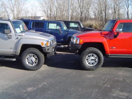

I know there have been quite a few posts about adjusting the torsion bars to minimize the rake
of the H3. I'm seriously thinking of making this adjustment. I know that I need to jack up the front end, turn the torsion bar adjustment bolts 2-2.5 times clockwise and that I need to have it alligned after making the adjustment (I have to do this before feb.8 to get the free allignment from the dealership).
for those of you that have already done this, what do you really think about this adjustment of the torsion bars? 2 or 2.5 turns?
It certainly looks better but, what about wear and tear. Is it a pretty easy adjustment to make. I'm a huge "Moab Freak" (off-road enthusiaste)I really am curious how this might affect wear and tear or performance?
Any input or suggestions would be greatly appreciated! Thanks!

I've gone about 10,000 miles since I've done it and not noticed any problems on or offroad. Never to Moab though.

I have 1000 miles and no problems. 2 1/4 turns.

I think I can see better now ( 2-1/2 turns ) Have had no one flash there brites yet. Very easy to do,, jack up the front end with a floor jack ,, get tires off the ground, mark the adjustment bolt with a marker and turn clockwise your desired turns. 2 turns is about 1 inch,, 2-1/2 turns about inch and a quarter. Theres pics on other posts that can help you too. Good Luck

I thought the headlights being higher made for better visability. If they need adjusted down, there is a adjustment just behind the grill. it would be real simple.

Well it's done!
I made the adjustment, 2.5 turns. Took it to the dealership for it's 7000 mile allignment and free detail.
It looks much better! and seems to drive the same. very easy! I deffinately recommend this adjustment!

I had the delaer adjust my torsion bars and other than the bounce in the front end being slightly more, it has not affected anything. I drove an H1 for years, so any ride is smoother. The dealer also realigned the vehicle for free as it was "pulling a little"

I am curious about it too. I want to raise the front a little but don't want to effect the ride much if any. I am thinking maybe 1 to 1 1/2 turns would help the looks.[/quote]
Most are turning 2 to 2 1/2 with good results.
