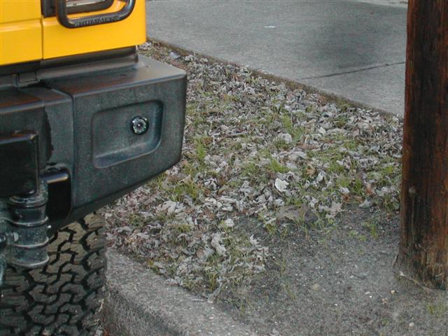

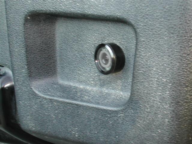

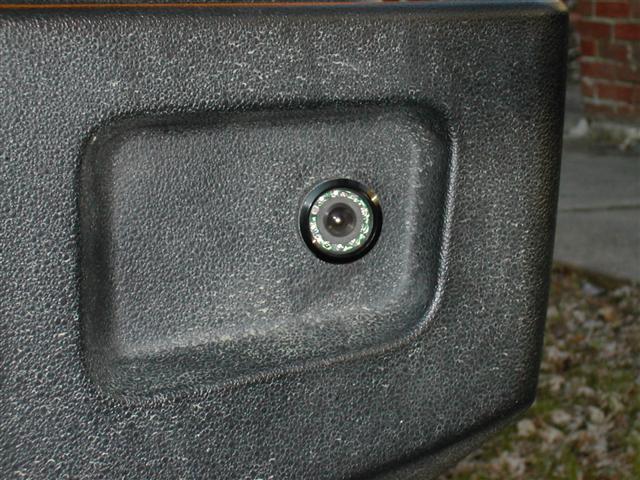

Here are some pics of the camera and display.

Clsoe up

Another

I hope this shows the angle, shooting across to the driver side. (slight angle)

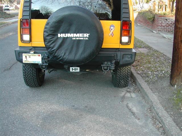

As you see below do to the 100 degree camera, I can still see the curb on the passenger side. This really came out nice, even with the rear tire on the back-
