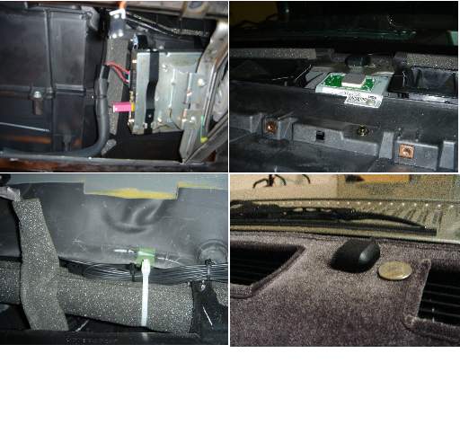

I didn't want the hassle of getting behind the headliner & I have the sunroof so no room. I used the Terk XMicro XM antenna. You have to modify the plastic connector on the tuner. Just shave off one spline with a razor knife. Easy. I started to install the NAV antenna exactly as in Klaus' great pdf then decided I wanted it moved as far forward as possible (reason it's cut strange). It mounts up easy and I added double stick tape also. The XMicro comes with 20' of wire. Just tie wrap up the extra to the defroster duct. Here's the final installation. You can see how small the Xmicro is. Most of us have dash covers here in Vegas because of the sun but it works equally well without it. Just use some double stick tape or velcro directly to the dash. Reception so far has been great for both XM & Nav. Thanks to Klaus & others for their previous experience/installs. Other pics to follow

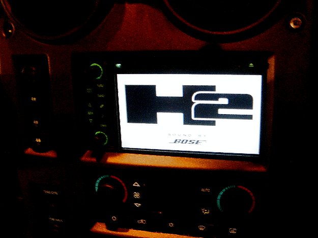

Other pics. And not one speck of rust behind the dash. Another benefit to living in Vegas!

I did the same install with the same antenna and used the exact position for the antenna, works pretty good, but it cuts out sometimes because the antenna is not on the roof, I have been using it for about 2 months now. It works well about 95% of the time.
