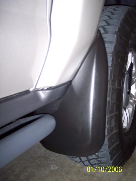

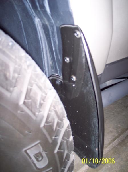

This photo should give you an idea of where the bolts are that you use as well as the location of the screws.
These are the Husky front flaps, not the OEM Hummer flaps.
Old 02-25-2006, 09:13 PM

DarthKarl is off the scale
An outside shot
