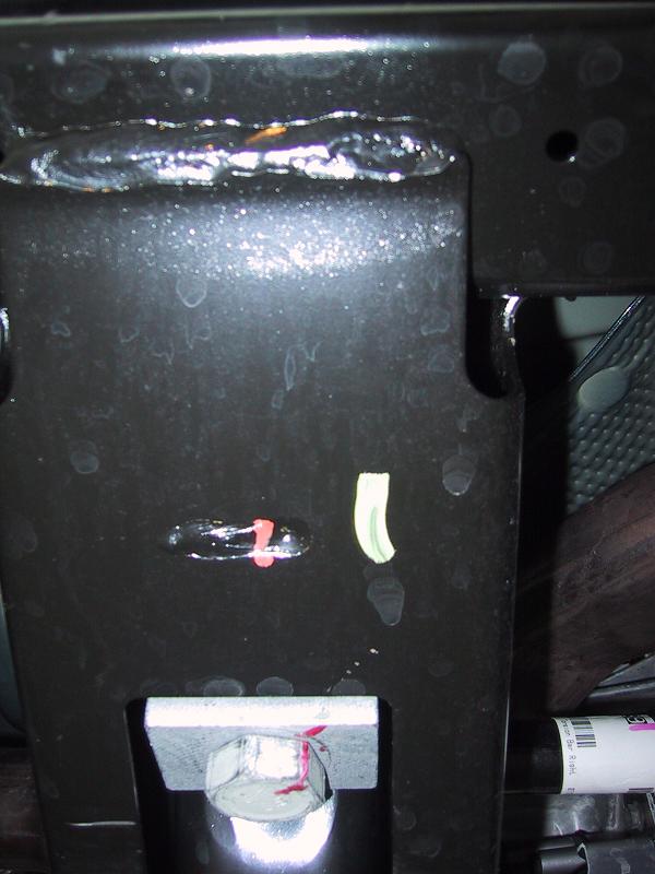

1. I took the floor jack and lifted the front tires off the ground.
2. I marked the bolts for the torsion bars with a red marker to give me an index point.
3. I then took a 1-1/16" socket and gave 5 full turns of the bolt and dropped it off the jack.
The end result...1 1/2" of lift on the front and alot more level appearance. I need to check the headlight aim and toe-in later...
NOTE: No offset keys were needed.

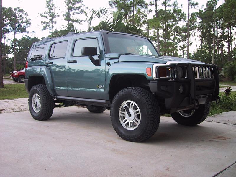

Leveled...Back is only 1" higher than the front now.

Old 08-11-2005, 01:02 AM
you turned them 5 turns?
How does it ride now? It has to be very stiff! I think you're the frist owner to do this. Give us an update when you get a chance please.
Thanks,
Tim.
