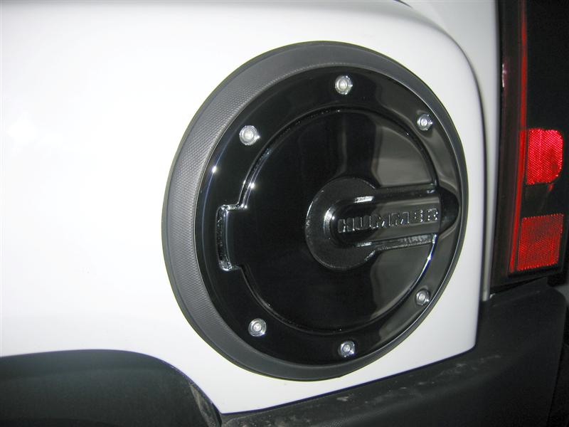

I say that because a friend got a door from a dealer that was a retro-fitted H2 door. It was sloppy too.
Anyway here is the new door, notice that the outer bezel matches the texture of all the other plastic trim and bumpers on the H3.
I would say, if you are unsure of templates and drilling, have the dealer do it. If you read the directions and take it slowly and check twice drill once, you can do it.
ALSO A NOTE: ONCE YOU PUSH THE UNIT ON, YOU CANNOT REMOVE WITHOUT CAUSING DAMAGE. THE PUSH PINS ARE A ONE TIME DEAL.
Good luck

Great pic and advice, thank you H3Lady. This is appearing black in the pic, must be the light reflecting?

Just a reflection, it is bright chrome and boy does it look good. I have the locking cap too inside.
it will keep out the elements and keep this area clean.
hey, if you had the dollars you could have the door power coated or black chromed. It does seperate from the bezel easy BEFORE INSTALLATION

Here goes
You pry/remove the original gas well with a plastic putty knife. It just snaps in.
You get a template and drill 5 hole around the edge. You get 5 speed nuts that go in the holes and stop.
There are 4 plastic fingers and 1 metal guide stud.
You light put the unit with the outer bezel on, until it stop. Open the door and from the inside there are 5 holes in the side, use a "L" shape allen wrench and hold each speed nut and put till it snaps to all five. You will know it's seated when the rubber washer around the bezel is flat..easy

For 18.00 do it. If he goofes, it's a new fender or cap he will need.
it only take 15 minutes to do...really
if you push it on crooked, you can't remove it. it will break the pins....

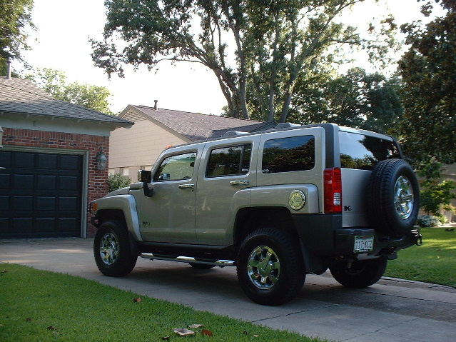

Heres the cap on the Boulder Grey, definitely worth the expense
