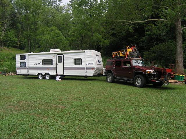

Lee, my opinion is the h2 will tow your trailer no problem. I've towed all kinds of stuff with mine with no prob. . I wouldnt tow for a living with it , but misc. trips it tows excellent. Heres a pic of a 32' trailer filled with motorcycles and a loaded h2. Around 19,500 pounds loaded on a 2000 mile trip. -Doug

Alec, I was down to 30mph a couple of times on big hills. But everthing takes hills hard , i have tractor trailers made for pulling heavy equipment and they dont like hills either. It was kind of surprising to me that when i had it rolling good (70mph) it sailed up hills excellent. I like towing the camper or my mini equipment with the h2 better than a pickup. The air ride is such a good leveler and cushy ride.

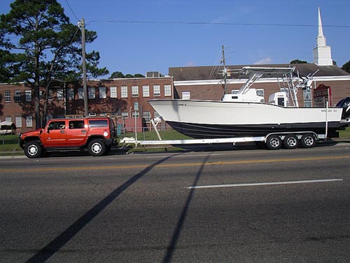

No air ride , and tows like a beast ???? not sure what everyone is crying about . I have towed this boat below with a hd2500 diesel , and 2500 v8 and the hummer , and the H2 does the best . In fact the short length of the hummer makes towing in tight spots and backing up much easier. Add the 4x4 and you have no ramp worries or wet grass issues.
