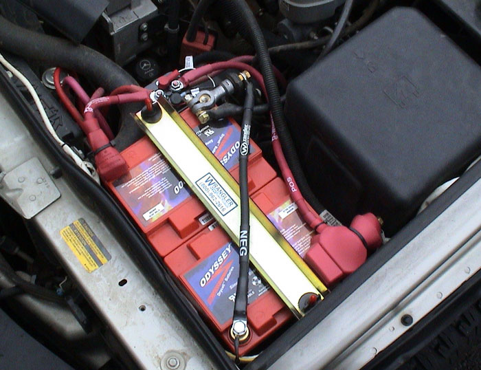

Patriot,
I love my dual battery set up. I did have a slight problem with one of the batteries, but Wrangler replaced it. they're dry cell batteries and some how one of them vented. The Odyssey battery rep had never seen anything like it.
Anyway, I highly recommend the set up.

that is a nice setup.. I never thought of actually getting 2 smaller ones but with more power. i have been envisioning of putting a second one of similar dimensions...

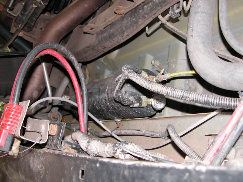

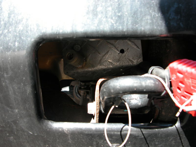

i posted that stuff before but couldnt find it with a search. i recently blew the airline running from the compressor to the tank.
gave me a chance to do some new things... but here are the pics of the tank and the quick-connects. i replaced the quick connects with the same ones plows use. they have rubber caps to keep the dirt out. sand, dirt gummed up mine rendering them useless. plus hadley came out with some rubber mounts and socks to silence the compressor which used to be pretty loud... now runs silent. I also put a switch in the cab to turn the thing off for when I dont want it to run.
unaslob
unaslob

Old 12-08-2004, 12:42 AM
unaslob unaslob is offline
Posts: 303
unaslob is off the scale
unaslob

Old 12-08-2004, 12:46 AM
Posts: 303
front
unaslob
