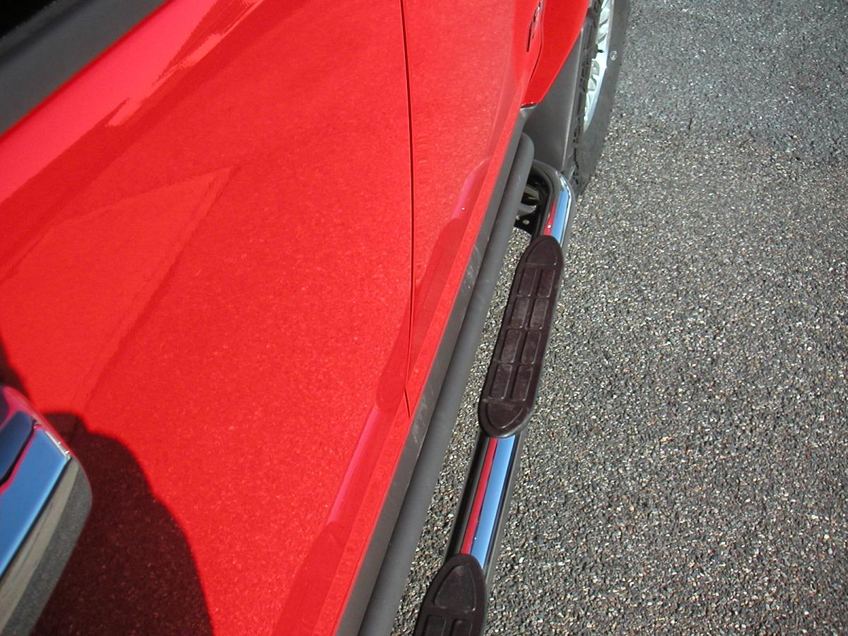

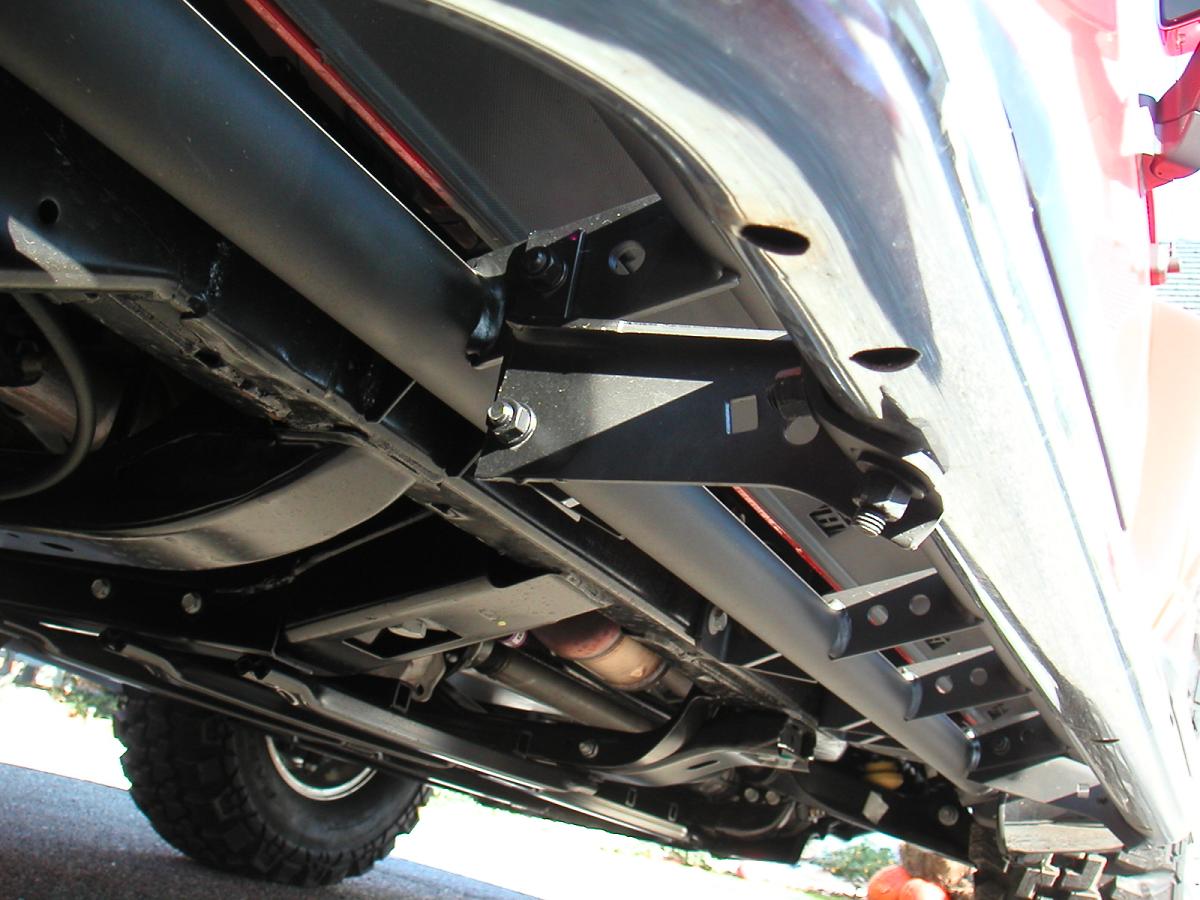

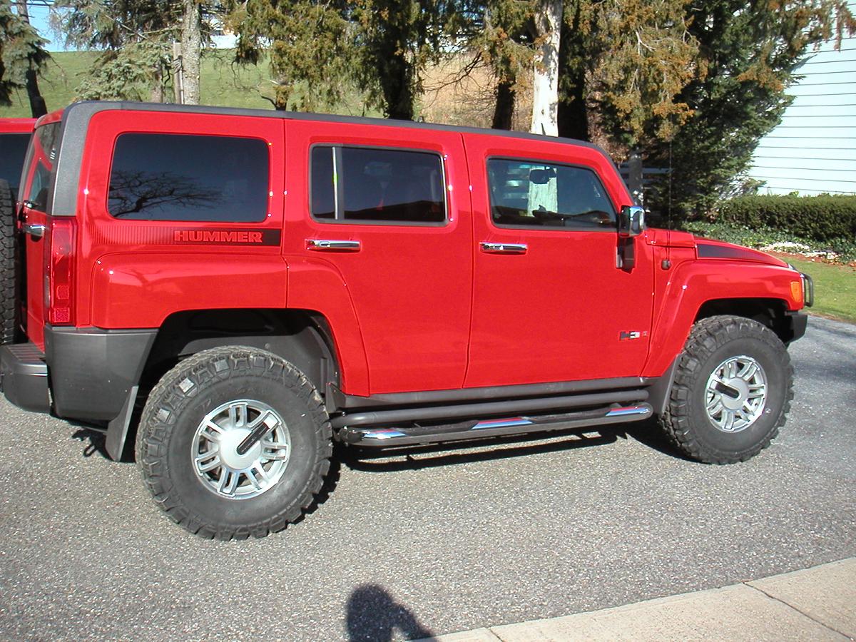

I think they are trying to tell you if you use your rock bars theres a good chance you will tear off the mudflaps. Yes they fit. I also put my tube steps back on under the rock guards with custom made brackets in almost the same stock location, 4 bolts and they are off.

Im new to puting pics. on the computer. Maybe my kid can do it. Just take the mounting bracket and cut the end off that mounts to the frame and redrill the holes in the tube step that mounts the bracket to tilt it up to the rock bar piece that has 2 holes in it . Drill the bracket to line up with one of the holes in the rock bar and bolt it. That is for the front bracket. The back bracket you do the same but add an aprox. 3 inch piece of flat bar to tie them in. (because I mounted it by the flat step area) and at the very ends use a threaded bar and drill through both bars and tie together. To do the first side it took me about an hour and a half to figure it out then the otherside went much easer in about an hour. and it looks factory.

Here are the pics. I hope this works.

Another pic

and another
