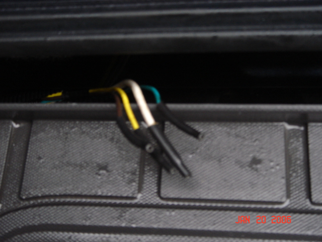

found this set of wires (BRWN/YELLOW/WHT/BLUISHGREEN), just wondering what they are for....If any of them is 12V ACC and Ground that I can use to power up a rear cam....
Thanks !

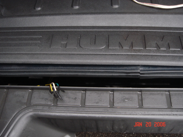

[ pic 2 close-up ]

Look like the trailer hitch wires.

<BLOCKQUOTE class="ip-ubbcode-quote"><div class="ip-ubbcode-quote-title">quote:</div><div class="ip-ubbcode-quote-content">Originally posted by Hummie3:
Look like the trailer hitch wires. </div></BLOCKQUOTE>
x2
Old 01-20-2006, 02:21 PM
Game Over Game Over is offline
Posts: 220
Game Over is off the scale
just what I thought when I first saw it....anybody know the codes for the wires ?
Thanks !

Not sure if those are for the OEM trailer but if so, here is some information from another post.
From the GM wiring schematics for the H3, the dark blue wire goes from the bundle under the I/P to the rear bundle for the trailer brake.
So, you could tap into the red wire (B+ through a 30Amp Fuse) at the I/P bundle attach this to one side of the switch, then attach the dark blue wire to the other side of the switch.
The rear fogs you can then power off the dark blue wire. For a ground, just attach to somewhere on the rear bumper should be good enough.
Old 01-20-2006, 04:05 PM
Posts: 220
<BLOCKQUOTE class="ip-ubbcode-quote"><div class="ip-ubbcode-quote-title">quote:</div><div class="ip-ubbcode-quote-content">Originally posted by H3 Hummer:
Put your tongue on them and taste and see.
</div></BLOCKQUOTE>
I did, four wires = four dots on my tongue, that's why 'm askin' from you guys that know better, anyway I think 'm ma leave it alone for now and grab power somewhere else....
Old 01-20-2006, 11:21 PM
f5fstop's Avatar
f5fstop f5fstop is offline
Location: Idaho
Posts: 4,744
The rear fogs you can then power off the dark blue wire. For a ground, just attach to somewhere on the rear bumper should be good enough. </div></BLOCKQUOTE>
That explaination was if you have the UY7 trailer package.
Back to the original question.
White: Ground (Can't get a dot on your tongue from this one, unless you grab hold of the battery B+ post )
Brown: Park Lamps
Yellow: Left Rear Turn/Brake
Dark Green: Right Rear Turn/Brake
(ME TOO)
