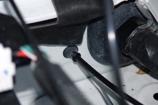

Old 02-28-2006, 12:26 AM
LostOne LostOne is offline
Join Date: Feb 2006
Posts: 5
LostOne is off the scale
Well I got the Radar Detector install...all wires out of the way now.
I pulled a set of wires from the engine area to under the dash via the Hood release cable race way. Then installed the ground wire onto the grounding bar next to the fuse box on the side wall. Install the hot wire on to #4 fuse (Roof Lamp) so when you turn on the H3 the Detector comes on and off when it is off. The wire for the detector to under the dash was easy to hide...just slip it uner the headliner and then down the side door plastic.
