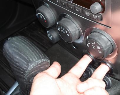

Great work. It's just that when I saw this:
All I could think of was "Da Shocker":
