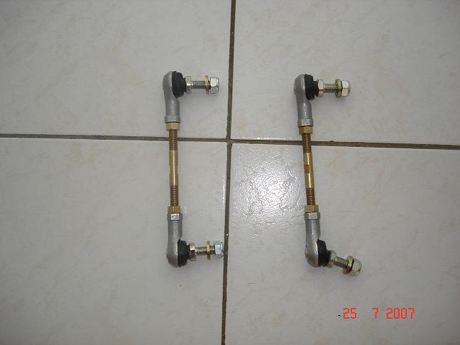

First a picture of the goodies:
This is the powergrid 10M-35 kit with THK balls that is about 1.4 inches longer than stock. The link has sealed balls, unlike the stock connector that just has a cap on the ball.

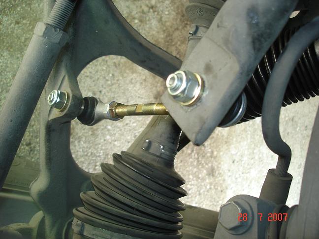

Then the connectors went in. Installation is easy. You can actually compensate the for the weight of the driver you want. I put them in neutral postions. Watch out! you can put them in wrong. If you put them the wrong way your tie rod will hit them at full turn. This is the correct way:
