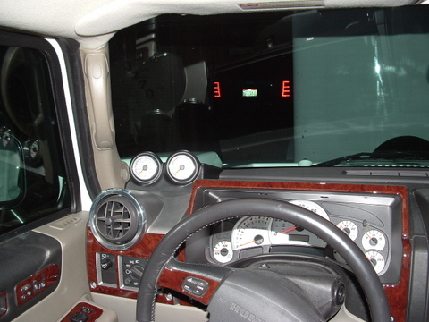

WORKIN WORKIN is offline
Location: Dayton,Ohio
Posts: 96
WORKIN is off the scale
Here is a pic of the gauges install.......
03 H2- polished stainless brush gaurds, front and rear. front and rooftop lighting, hard cargo carrier....

Old 03-23-2006, 03:54 AM
Humdingah Humdingah is offline
Posts: 407
Humdingah is an unknown quantity at this point
Workin,
Where'd you score the gauge pod? Much nicer than the $300 piece from Lingenfelter that puts it behind the steering wheel!
Old 03-23-2006, 09:10 AM
Posts: 96
Originally posted by Humdingah:
Workin,
YOU CAN GET THEM HERE..http://cgi.ebay.com/ebaymotors/Speed...spagenameZWDVW It's a whole 39.00 for the pod, and fits perfect.........
