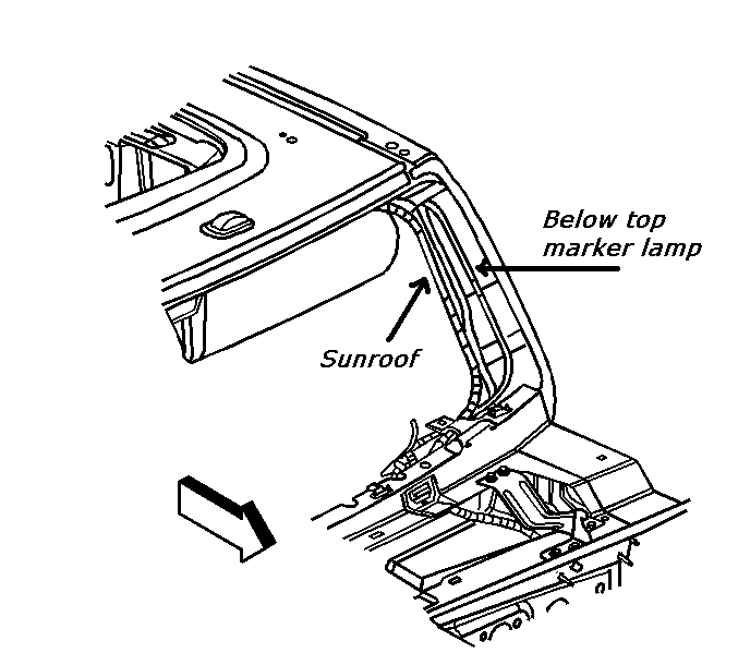

Old 04-03-2005, 08:30 PM
Dan Dan is offline
Location: Cognito
Posts: 2,155
Damn! You beat me by one minute with the pic!

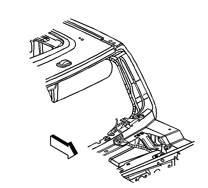

Dan Dan is offline
Location: Cognito
Posts: 2,155
Here is the front drain hose schematic, if its any help to you.
Old 04-03-2005, 08:18 PM
Location: The Green Mountains
Posts: 2,823
VTSTOMPER is off the scale
ok, under the marker light is a hole that the wire goes down. It is not wet under the light per say...but there is water in the hole...weird.

Old 04-03-2005, 10:48 PM
Posts: 2,823
LV, yeah, I really was not deep into it on that earlier post...but see below:
I put RTV around the inside of the marker lamp gromet, and then stuck it back on...it was dry under it, so I do not think that is it. But, I will do the hose test after the RVT dries.
What else can cause a leak up there other than the marker light? Only the sunroof? I also looked under the dash...looks dry..I am pissed I cannot find it. It IS coming out from the metal under the kick plate.

Old 04-03-2005, 08:29 PM
LasVegas LasVegas is offline
Join Date: Aug 2003
Location: \"Lost Wages\"
Posts: 1,150
LasVegas is off the scale
drain routing. This might help.
