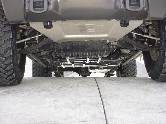

03-16-2006, 08:31 PM
I just got back from my morning adventures at the dealership diagnosing the noise issue.
The shop foreman took a drive with me and heard the sound I had been trying to describe. Put it up on the rack, while I'm enjoying my cup of coffee in the waiting area, he comes over and says, " would you like to come back and see what is going on with your truck?"
My heart sank......I was trying to be stong. We walked back into the shop and there was the patient, Bebe Rhino lifted way up in the air.
He walked me over to the her, said "watch you head" as he lead me underneath the truck, then asked me to turn around and to first look at the gas tank cover....it was pretty flat. As in smashed.
Then he asked me to look at the cross member...it was bent.
He then showed me the UCP and how it was bolted on. In front, where it is bolted on the the second skid plate you could see how it was higher on the drivers side. The second skid plate is also smashed
In installing the UCP they had a difficult time getting it on, because everything was out of whack. But they installed it anyway.
Apparently the noise was the second skid plate binding, and causing a rattle when I hit a bump.
So they took the UCP back off, and with cro-bars and pry bars, got everything as unsmashed as they could, reinstalled the UCP and guess what.....no noise!!!
Or at least it is much better and less severe than it was. They said if I want it to totally go away, they would need to replace the bent crossmember.

hey Bebe , how do you smash your fuel tank protection when sewie and i havent LOL, you are hardcore  , did you go someplace that your keeping secret from us  LOL
03-17-2006, 12:39 AM
Well, have you looked under your truck lately boys????
I'm gonna say it was the quinn river bank in Black Rock Desert. It had the tell tale signs of white mud streaks on it.
03-17-2006, 12:41 AM
mine looks fine see  but i did need a sledge to get my UC protection on LOL
