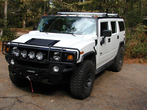

alldun, I have the light bar and love it, although I do have 4 PIAA 580SMRs on it instead.

The Warn light bar is great, but I have no experience with the lights in question. I had no problems installing the light bar, took 10 mins or so, but I mounted the lights before installing tha light bar.
</div></BLOCKQUOTE>Same here.

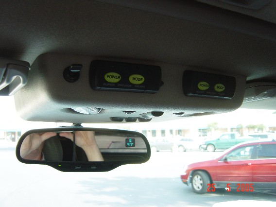

My switches

Nice clean work, James. How do you like the lamps?

When the search feature came back alive, I done a search and found out James had these lights. I asked him about his switch install and this is what he sent me. I think it looks damn good. Matter of fact I am in the process of getting pricing for these lights and the Delta 10x light bar (this **** is not cheap btw). I think I will use those switches and mount them like James did. As good as that looks, I don't see any since in going to the trouble to install new ones. I think James has the 50,000 candlepower lights and I am looking at the 100,000 cp lights, but yea James I didn't ask: How do you actually like them?
