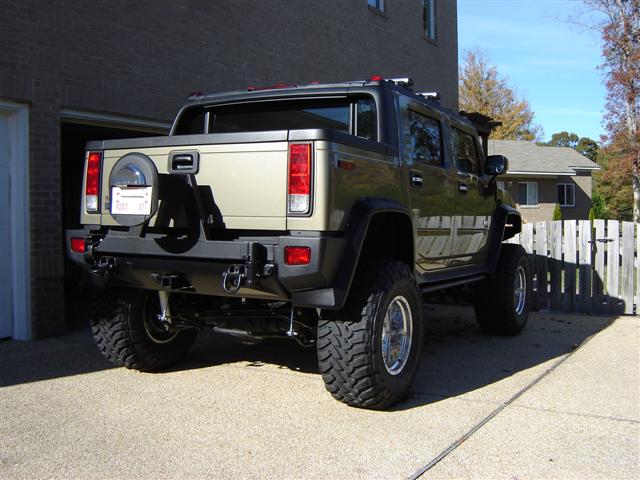

As far as looking level, look at the pics of KenP and PhilD trucks. Both have 38's and Fabtech 6".
